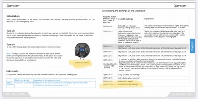

hello, I have a problem with my SL AF7: when I connect it to battery, sometimes it does not turn on but the "SL" indicator turns blue. sometimes it lights up like it's night when it's daytime. I think it needs to be repair. I have another question: I have a bikepacking bag under my handlebar extension. how can i fix the SF AF7 on the extensions? Thanks for your help.

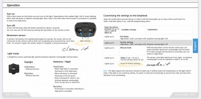

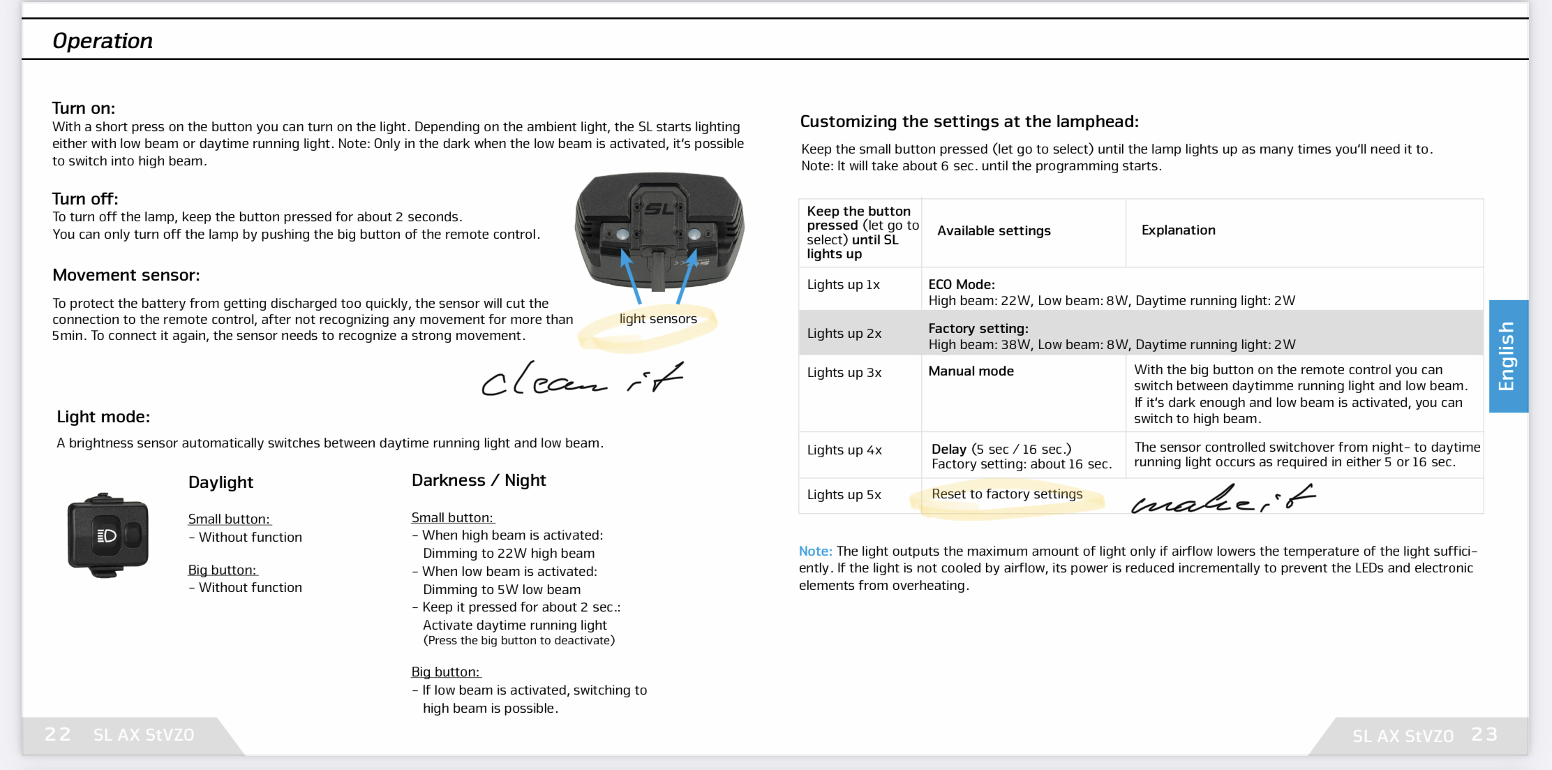

Hello and thank you for this document.
Unfortunately I have a problem. First , it is impossible to make the lamp flash 10x for a reset. The sensors are clean and I have a random behavior of the lighting: see video on this link:
https://youtube.com/shorts/96YE5QxUOps
