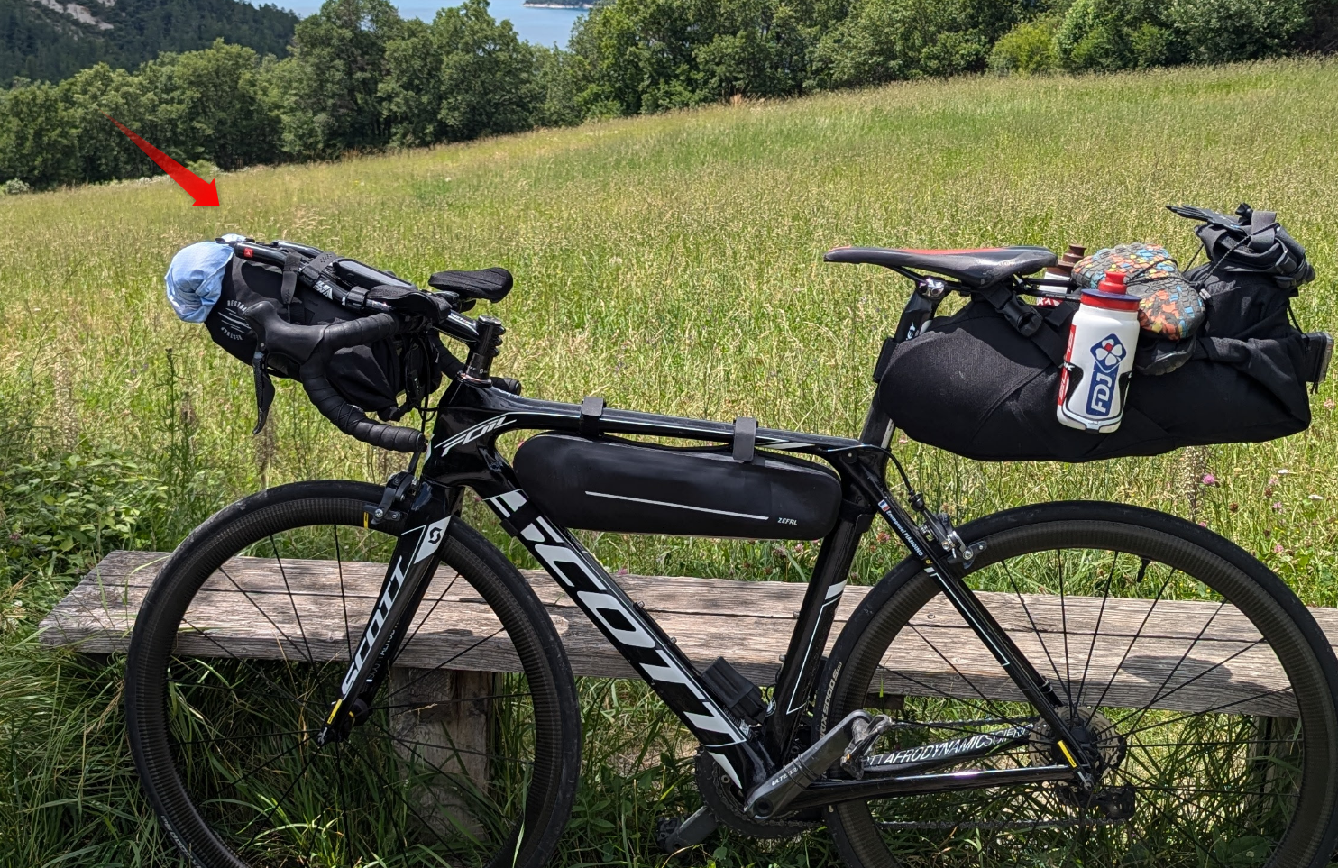

Hello everyone, I do bike packing and I have a bag attached to extensions. Is there a solution for attaching SL AF7 lighting? Thanks for your help

Hi Scolette, as far as I know, there is no standard solution for attaching your SL AF to the end of your TT bars. (red arrow)
In addition, the longer the lever arm of these TT bars is, the more unsteady the light becomes and it starts to shake slightly.
Looking at the picture of your bike, it may be possible to mount the SL AF with the Classic Mount securely and stably where your front wheel brake is.
Have you already considered this option?
https://www.lupine-shop.com/Ersatzteile ... -und-SL-BF
Another alternative mounting option would be with the GoPro spacer for the steering axle below the stem.
And an extension for GoPro.
https://www.lupine-shop.com/Ersatzteile ... ter-Spacer
Greetings Frank

Somewhere in the forum is a picture of a custom-made mount, which is attached between your aero bars. Lupine designed this for one of their athletes. Here is the link to the post:
viewtopic.php?f=54&t=7629&p=44036#p44035

Since the bracket has a GoPro Interface, it can be used for an SL AF as well. I would only mount the bracket for the shown Bike upside down.

Scolette, I recommend that you simply search for a TT Bar bridge on the Internet.
You will quickly find various offers which you can use together with the standard bracket of the SL AF.
For example:
https://www.ciclisport.com/accessories/ ... ack__36209
https://365cycles.com/products/full-spe ... idge-black
and many more, cheers Frank

Hi Scolette, I just discovered this GoPro mount by chance:
https://brightside.bike/product/riversi ... ght-mount/
I've never come across one like this before.
This one mimics a piece of "handlebar" at the end.
Maybe this one can be used.
