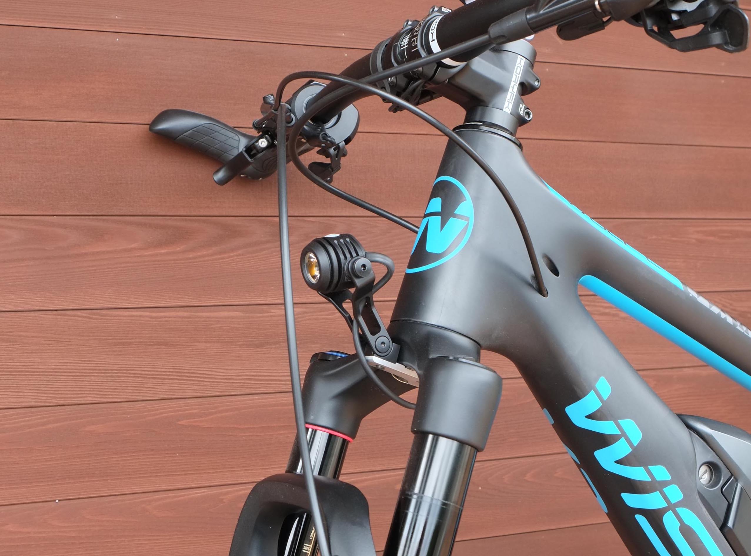

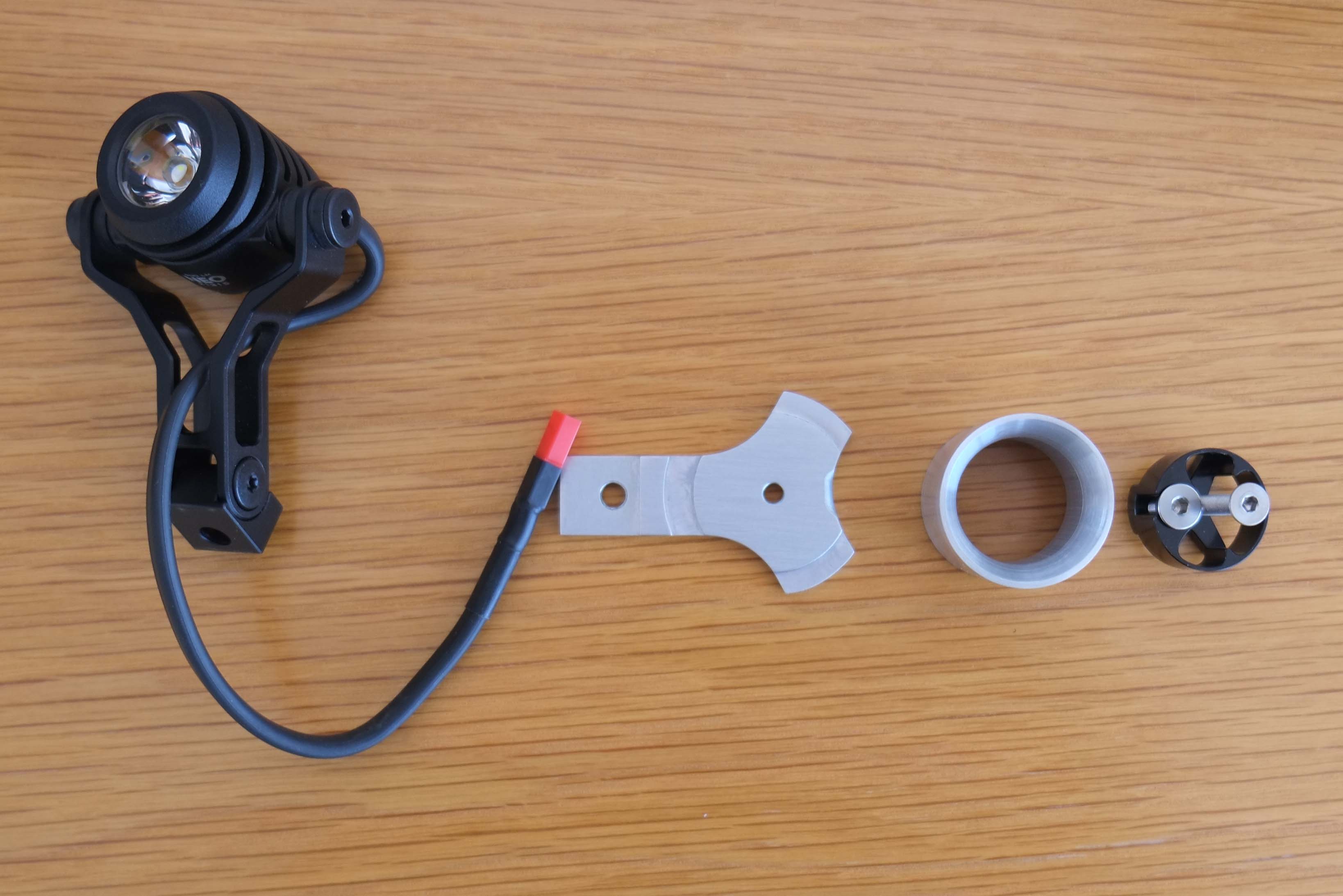

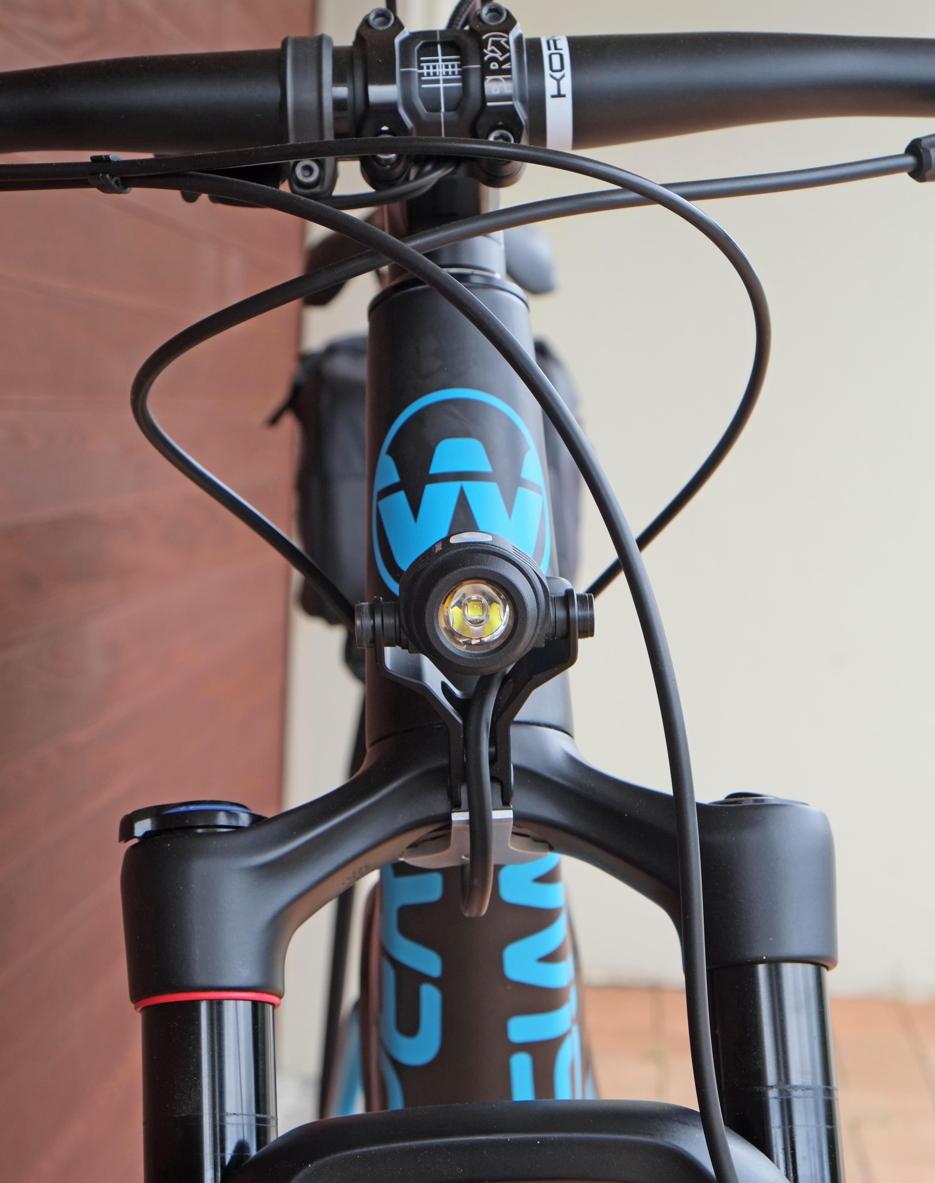

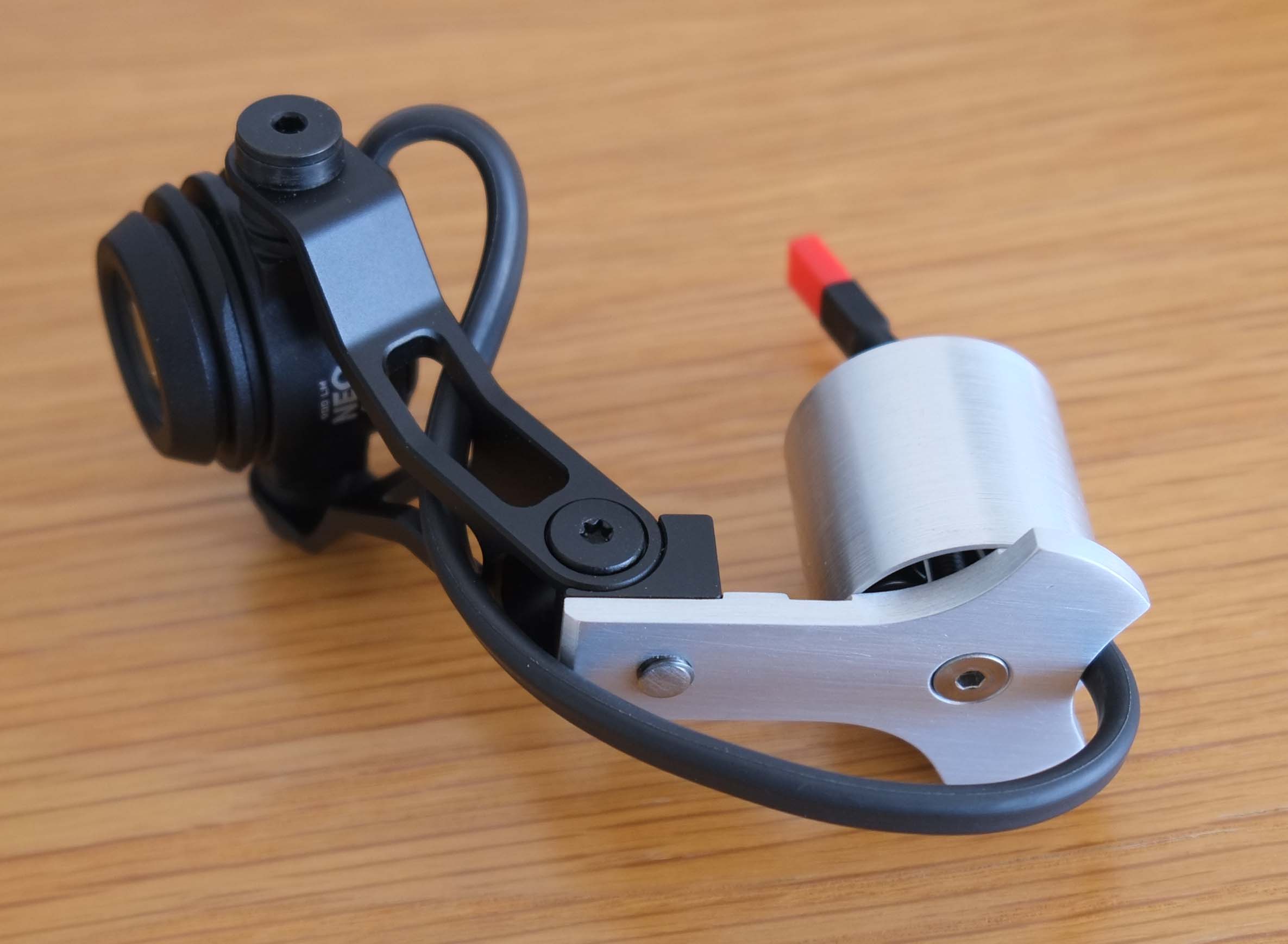

My take on mounting a Neo onto the fork steerer tube using Lupine's classic mount and two stem kit bolts. The bolts required the drilling of the mount and the addition of four 3 x 11mm dia. nylon washers. Custom parts included 32 - 25mm dia. alloy tube, a piece of 4mm alloy plate for bracket and Trickstuff stem clamp. The Neo is powered off Shimano 8000 motor aux power (6V 2A). Cabling internally routed and connected by JST connectors inside steerer tube.
